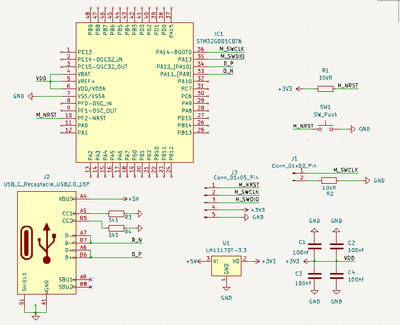

2024-04-10 6:52 AM - edited 2024-04-10 6:56 AM
Here is the schematic for refence in The same design I used both STM32G0B1CBT6 & STM32G0B1CET6
The STM32G0B1CBT6 is working But with STM32G0B1CET6 not working I check in STMCUBEMX Both are pin compactable just memory size is different.

2024-04-12 10:05 AM - edited 2024-04-15 6:15 AM

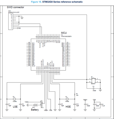

I don't see something suspecious in your schematics except the nRST pull-up resistor. No need for this resistor as there is one internal on the chip.
You can refer to the reference design provided by AN5096 / Figure 15. STM32G0 Series reference schematic:
This statement makes me having a doubt about the chip itself. It could be broken. Is there a possibility to desolder this chip and solder one you know that is working?
