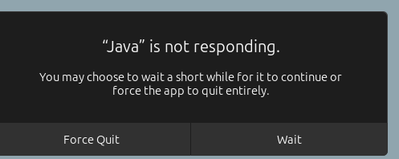

Not able to start IDE version 1.15.1
./stm32cubeide_wayland
or
./stm32cubeide
After choosing wait the same message keeps coming back.
Linux console shows:
Invalid condition id : UX_CORESTACK_Condition cause : null
No problems dlike that when using CubeIDE 1.10
Totally stuck now and cannot continue working on projects....
SOLVED:
(Finally able to edit this, ST community website is extremely slow)
1. Remove the .metadata folder in the workspace
2. Start CubeIDE. (all projects are gone, don't panic...)
3. Select Import project from filesystem (this may crash a few times, during loading some "C" stuff"). ad complianing about some dependencies missing,, just keep trying...
4. Finally it works.
