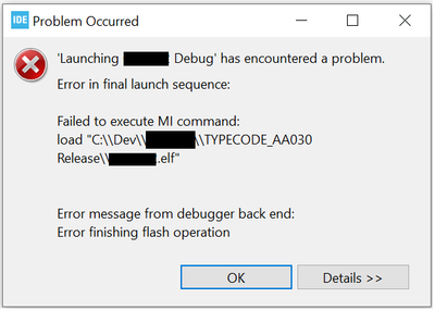

Further info, I also get this dialog when the debug fails:
