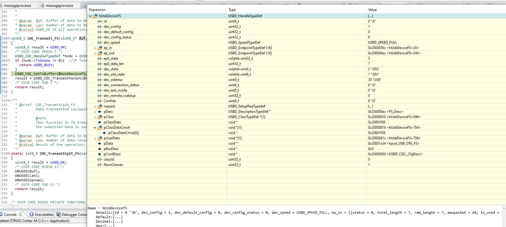

Hi. I am using the debugger, and sometimes I hover over the objects to see their values, like so.
One of the issues I've run into is this.

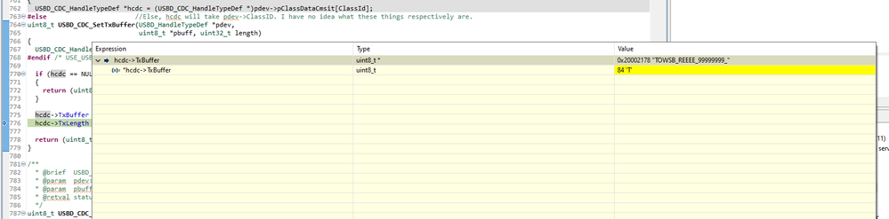

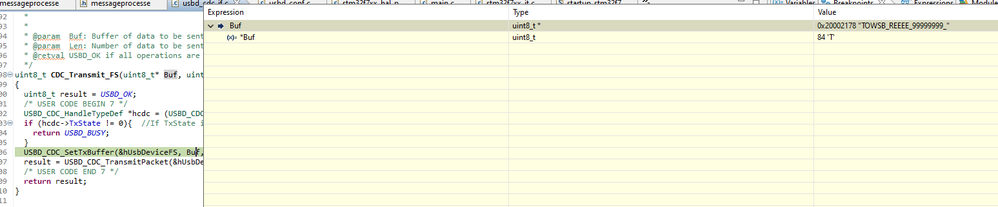

On many of the expressions, I cannot expand the details of the expressions, even though I am sure there are further information in there. For example, pClassDataCmsit. In this screen, there is no further details to this element of the class. However, in this other code, the further details to this element can be seen.
I am unsure how to see the details of elements like these at all times, I only know that I would quite like to have these details available at all times. This is the code in question:
