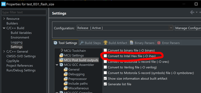

2023-10-14 7:00 AM
Conversion to hex file is an option available in project output settings.
If the current HEX file is different than your code, then it wasn't generated with this process.
2023-10-14 7:00 AM
2023-10-14 8:27 AM
Generate fresh binaries or hex files from the .ELF file using objcopy
