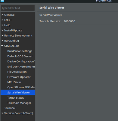

Trace buffer has a fixed size, but you can adjust it to your needs, as written in the message.

If you only have messages and it fills the buffer too fast, try reducing the message count and size, or/ and set a bigger buffer size, as shown in the message you got.
( In IDE... preferences...)
I set it at 2 MB or so, should be enough.

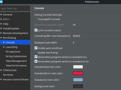

2025-08-15 1:58 AM
Try ...console settings: - no limit , - bigger buffer
+ increase trace buffer: 2MB -> 20MB
in swv settings, dont enable any trace events like: resolution, cpi etc.
