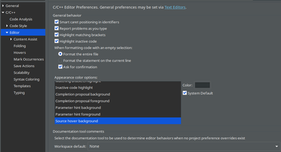

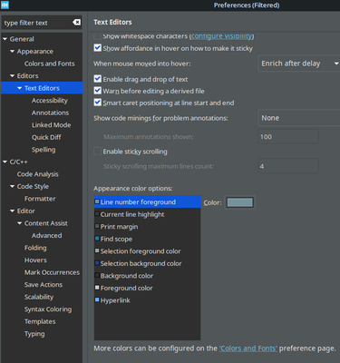

there are so many elements to choose, just try yourself, to get the colors you like:
right click in editor window -> preferences
you see:
- or

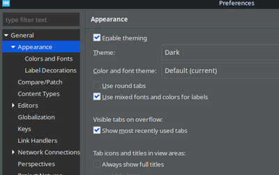

in menu : Window -> Preferences -> General -> Appearance
+ on some colors/settings , IDE needs restart, to get all colors set .

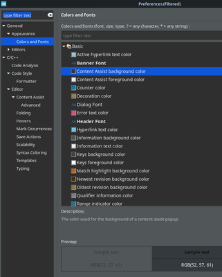

2025-05-17 12:42 AM
Thanks for helping.
I tried and changed some of these colors but the text of the code is still not visible - probably the background color and the text color are the same.
The suggested "content assist... " parameters are not related to this issue

2025-05-22 1:27 PM
Editor->Source hover background and tick on <system default > worked
That solved my issue.
