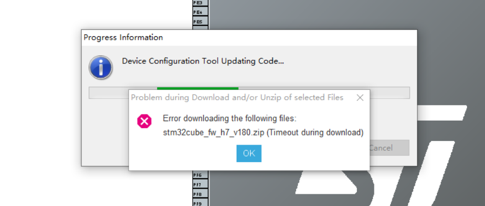

New a project for generating code while install the STM32CubeIDE first time. I try to close my firewall but it doesn't work.

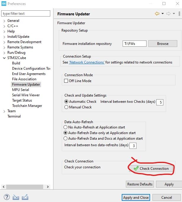

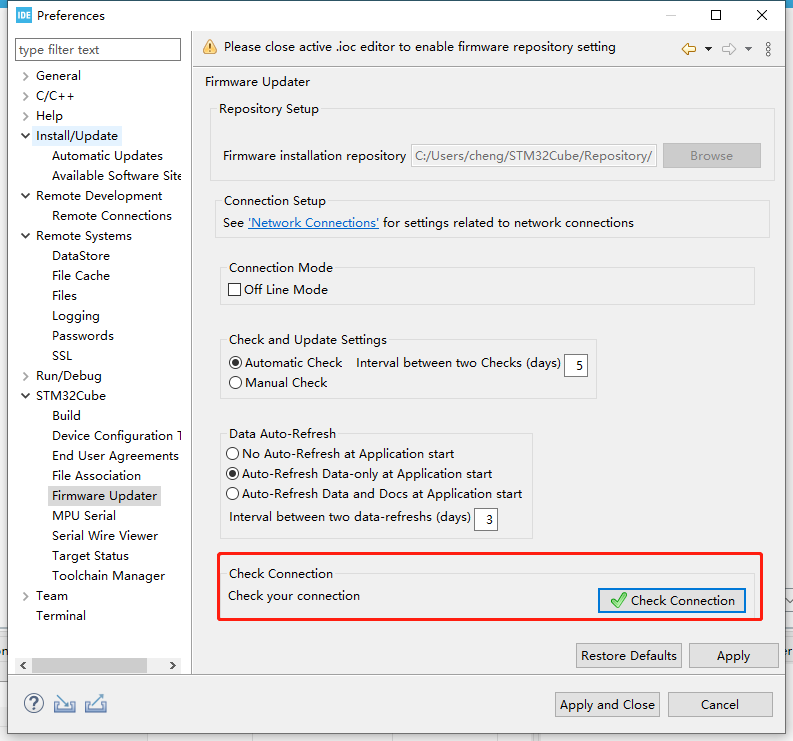

Is your network connection ok ? Windows > Preferences ...
2021-01-19 12:08 AM
Yes!
