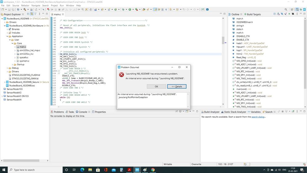

Hi Mattias.
Everything was working fine till now with the Version 1.5, till today - however today when I started to debug, the same problem has now started with Ver 1.5 also. I get exactly the same message as the screenshot given earlier in my thread.
"An internal error occurred during: "Launching SensorNodeV4 SN103".
java.lang.NullPointerException"
I am seriously at a loss what to do. Please help!
