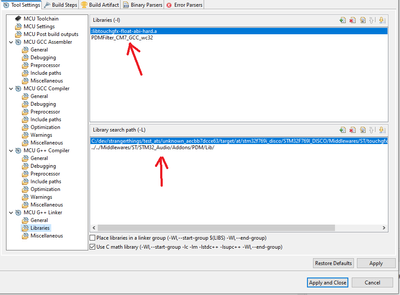

Since we don't have a visibility of what kind of library you are using we cannot help you.
If you have a .a library file you need to add it in library section as shown before.
If you have .c files you need to add them in the in project explorer using drug and drop function here:

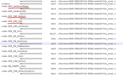

You have to check the map file (.map in \STM32CubeIDE\Debug): so are you really calling the library APIs?
Example:

@Hardik02 wrote:How i can know the exact memory size used by library?
Analyse the Map file (aka the Linker listing).
nm is a tool to do that: https://en.wikipedia.org/wiki/Nm_(Unix)
Part of GCC binutils: https://ftp.gnu.org/old-gnu/Manuals/binutils-2.12/html_node/binutils_4.html

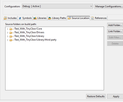

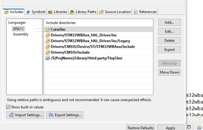

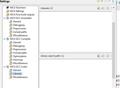

I just directly copy the source file added into library folder and then give path into C/C++ General and paths and symbols.
I didn't find anything here.
