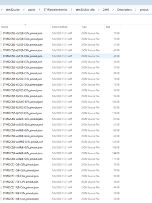

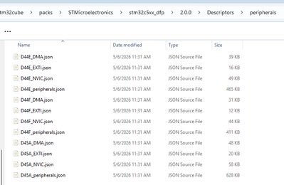

christophe_M
The STM32_open_pin_data repo is only a subset of MX1. We retrieve inside only STM32 families supported in MX1.
For MX2 we have a datacentric approach and information related to peripherals, pinout, clock are available directly in the C5xx Dfp pack in some json files.

christophe_M
As explained it is not planned to add xml files into STM32 open pin repo for series not supported in MX1.
The same info are now in the json files of packs delivered and compatible with MX2.
The dfp C5xx is delivered publicly in this repo :
https://github.com/STMicroelectronics/stm32c5xx-dfp/tree/main/Descriptors
All packs for C5 are available here : https://github.com/STMicroelectronics/STM32Cube_MCU_Overall_Offer/blob/master/STM32Cube_STM32C5.md
Third party solutions should use now json files instead of xml for new series like C5.
CMO
