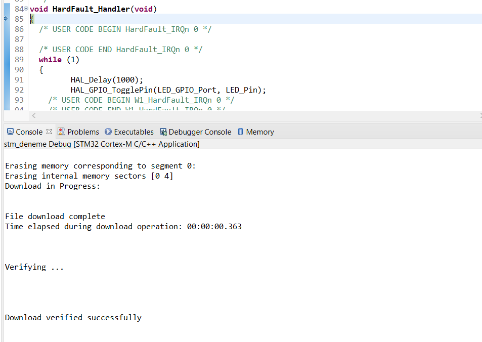

2022-01-17 12:48 PM
I do everything like videos but my stm32 don't blink with Cube IDE. By the way its working with Arduino IDE. What is the problem? Thanks for replies.

2022-01-19 5:15 PM
STM32F103C8 ( Blue Pill) and St-link Mini Sir. I tried program with Cube IDE.
2022-01-20 12:14 AM
Pleas show your pin configuration window, how GPIOs are configured. Also check if LED_GPIO_Port and LED_Pin are connected to the LED on the board you use.
