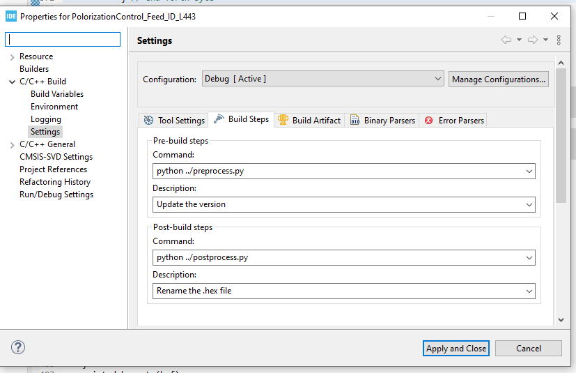

Then you have to have the IDE program call them. Select the Build Steps Tab

Add a "post compile" build step that runs a batch (or even better as shell/bash script) to do this. Go to the project properties, an don the "C/C++ Build"->"Settings" dialog, click on the "Build Steps" tab.
2023-02-03 2:26 PM
I think I have a start.
I was looking at the Properties->C/C++ Build->Settings->BuildSteps Tab and they have a pre-build command and a post-build command.

os.chdir(cwd)I set the Project->Properties->Tool Settings Tab->MCU Post build outputs
And clicked "Convert to Intel Hex file (-O ihex)
