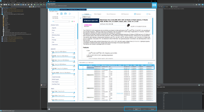

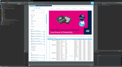

Hello @badi1
The warning is intended to be their unless the user select a target or an example. The same goes for the "Next" and "Finish" buttons.
screenshot before selecting a target:
screenshot after selecting a target:
I hope this give you a clear answer to your question.
