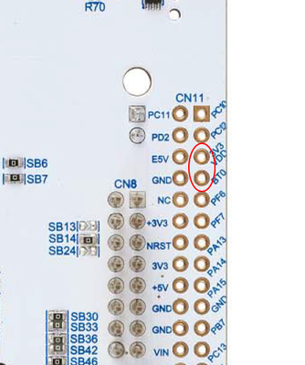

Try setting BOOT0 to High (set Jumper before powering the Board!).
On the NUCLEO-H7A3ZI-Q BOOT0 is on CN11 Pin 7, You can Jump this signal directly to CN11 Pin 5.

2025-07-21 4:29 AM
Hi @Andrew Neil @MHoll.2 Thanks for reply. Now it is working
