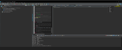

screenshot of the problem
where as you can see firstrun should be 1 and firstZDAGps is also 1 so we have everthing is shifted down.

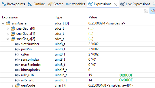

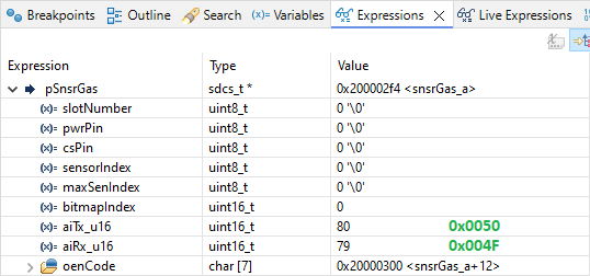

I have an array of structures:
typedef struct sdcs_struct
uint8_t slotNumber;
uint8_t pwrPin;
uint8_t csPin;
uint8_t sensorIndex;
uint8_t maxSenIndex;
uint16_t bitmapIndex;
uint16_t aiTx_u16;
uint16_t aiRx_u16;
char oenCode[6+1];
} sdcs_t;
sdcs_t snsrGas_a[3];
sdcs_t *pSnsrGas;

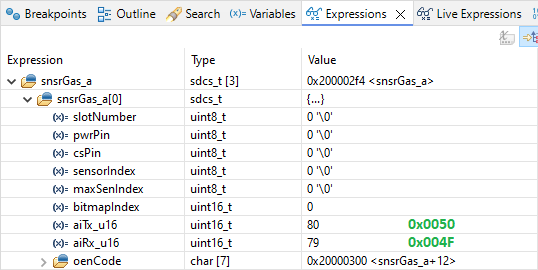

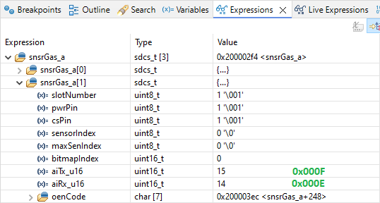

In the "Expressions" window it is displayed correctly.

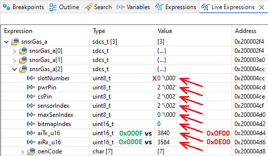

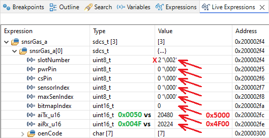

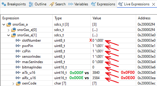

But in the "Live Expressions" window the items are shifted by 1 byte.

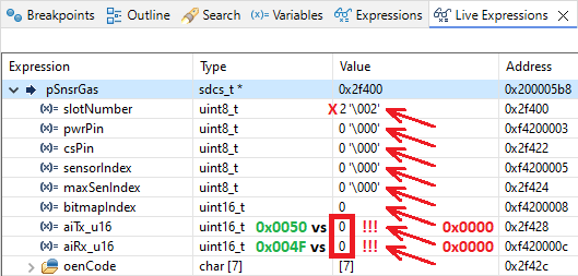

What's more. Look at the addresses in the "Live Expressions" window for the pSnsrGas pointer. They don't make any sense at all.
Correctly displayed content in "Expressions" window
(order: pSnsrGas, snsrGas_a[0], snsrGas_a[1], snsrGas_a[2])
Incorrectly displayed content in "Live Expressions" window
The items 'aiTx_u16' and 'aiRx_u16' in the pointer even have a completely different value, zero.
