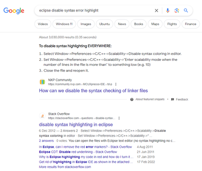

I spent hours trying to deactivate this error, including the google example, but I was unsuccessful.
Now, I'm trying to understand what you're telling me about the preprocessor...
I have difficulty understanding because the little I think I know is that the preprocessor concerns GCC but here I have no problem with GCC
