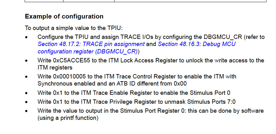

Hi, I am trying to get printf functionality work on Discovery kit IoT node board, however it doesn't seem to work.
I went through the user manual and performed the steps mentioned, screenshot from ITM section in user manual is given below,
and below is in the code snippet

Doing a lot of unnecessary and duplicative initialization, good chance you're stepping on yourself. Try to separate the SWV initialization from the character output.
The LAR isn't typically used on CM3/CM4 parts, first needed it with CM7
