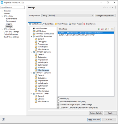

Then, in C/C++ Build -> Tool Settings -> MCU GCC Compiler -> Include Paths, remove ../Middlewares/ST/touchgfx/framework/include and ../Drivers/STM32F4xx_HAL_Driver/Inc from the list of Include paths. Once that's done, re-include them by defining "-isystem" flags for those paths in the "Miscellaneous" node's "Other flags" list:
The reason for this is that by including paths with "isystem" instead of just "i" implicitly tells the compiler to ignore all warnings generated by headers in those paths.

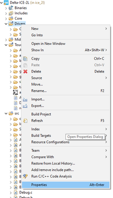

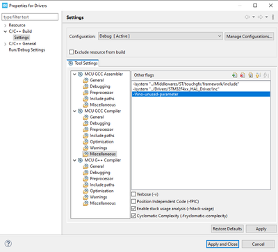

Most of the libraries in our project are grouped under the "Drivers" subfolder. Right-click on it and choose "Properties":
Under C/C++ Build->Settings->MCU GCC Compiler->Miscellaneous, add "-Wno-unused-parameters" to the list of "other flags" to suppress the "unused variables" warning for all source files under the "Drivers" subfolder:
Note that the two "-isystem" flags we added earlier were already automatically populated. However, also note that if we further change the parent project properties, those changes will no longer automatically propagate to the "Drivers" subfolder properties.

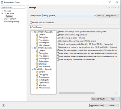

Continue by going to the "Warnings" node and unchecking the warning options so as to match this screenshot:

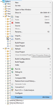

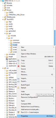

Once that’s done, we need to drill down into the TouchGFX subfolder and reenable warnings on a tiny bit of application code buried therein. Go to TouchGFX -> gui -> src, right-click on "model", and choose "Properties":

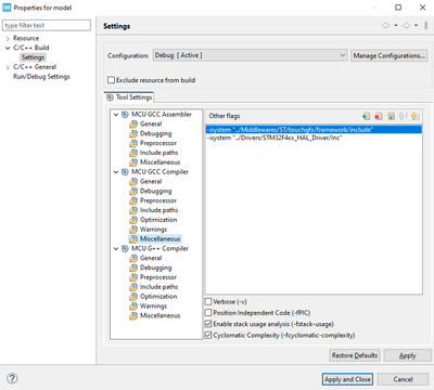

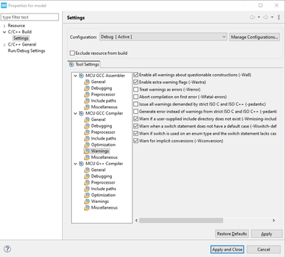

In those properties, undo the warning suppression meant for the library code by deleting the "-Wno-unused-variables" flags and re-checking the warnings that were disabled in the earlier "TouchGFX Properties" step:
Be sure to do the same for both the "MCU GCC Compiler" and "MCU G++ Compiler" nodes.
