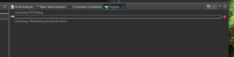

I am trying to use a Nucleo-F103 board with STM32CubeIDE (v1.16.1) on Windows 11.
I have installed/uninstalled the IDE several times over the past few days but every time I get stopped at the beginning of the programming process (the code compiles OK).
The message I have is "Launching : performing pre-launch check" and that's where it stops. I occasionally get a message "Termination of previous launch did not complete successfully" but that doesn't help much.

There is nothing in the console. I have just checked with the other PC and that has output from the moment I press the button. The work PC has nothing.
I have tried using the STM32CubeProgrammer CLI and that works as expected. Tried using the STM32CubeProgrammer GUI and that works too - both on the work PC.
I don't think the USB is the problem as the IDE can scan for the STLink and find it.
In the progress pane, under the launch progress bar, there are a lot of messages about what look like downloads but they're so quick I can't read them. This only happens after the IDE is restarted.
