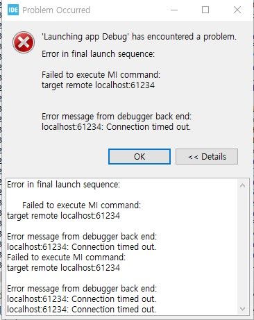

I deleted CubeIDE and reinstalled the latest version 1.10.1, but it still doesn't work. The test environment was tested with NUCLEO-G071RB with the most basic code. Even if you delete and reset the RUN and DEBUG configration by referring here and there, only the warning as shown in the figure pops up. Thank you for your help.

2022-07-21 1:58 AM
Hello there,
I tried this on two different workstations in the office but I can't seem to reproduce. Could you give more details about the steps you do in order to get this problem?
Is it only this specific project or every project?
2022-07-21 4:15 PM
Thanks for your help.
Everything from example projects to development projects is included.
I installed CubeIDE on another note PC and confirmed that there was no problem during the test. Is there a problem with my note PC? I am worried about whether it will be resolved by formatting the note PC.
2022-07-22 2:21 AM
I have the exact same error.
For me, this error came up when I did a Firmware update at my STMG071-DISCO Board.
It also happens on a firmware update of the ST-Link/v2 Debugger/Programmer. So both are not working anymore.
I still had an old STMG071-DISCO Board, which still works with its initial Firmware. I therefore wanted to downgrade the Firmware from the upgraded DISCO board back to its initial version. I downloaded the ST-Link007 V2.38.27 and programmed the DISCO board with its initial firmware. However the error still remains the same.
For everyone else, who did not yet do the firmware update, the following helped for me: Revoke the firmware upgrade request, when clicking on Debugging in the STMCubeMX IDE.
2022-07-24 5:03 PM
So, isn't there still a solution? My problem is also occurring on the PCB board for development including the STMG071-DISCO Board. Please help us for smooth development.
