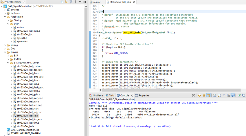

The only issue I saw was the compiler didn't uncomment the code in the stm32u0xx_hal_spi.c, in between the define HAL_SPI_MODULE_ENABLED

Here is a screenshot to show that the SPI driver was added and that HAL_SPI_Init is not commented out after the temporary HAL_SPI_MODULE_ENABLED fix. I can also build with no errors. I've attached the project.
