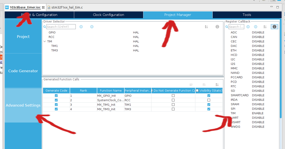

In CubeIDE 1.5.1 in ioc device configuration tool select tab Progect Manager, sub Advansed setting on left side, on rigt side You will see register callback list.
Choose what You need

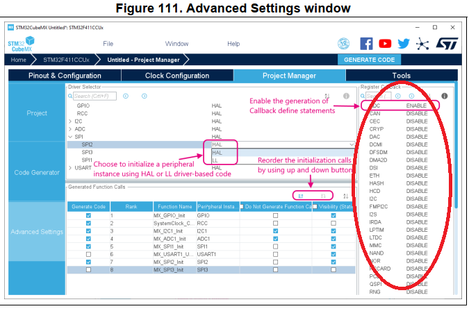

The cleanest solution I could find is to modify it using CubeMX.
Select Project Manager->Advanced settings (Also mentioned in the help pdf)

Hello, i found your awnser.
In CubeMX, go to "Project manager", in the left side you will see "Advanced Settings".
if you go over there, you can see all Register Callbacks on the right side. They are all disabled my default, you can eable them there.
GL ^^

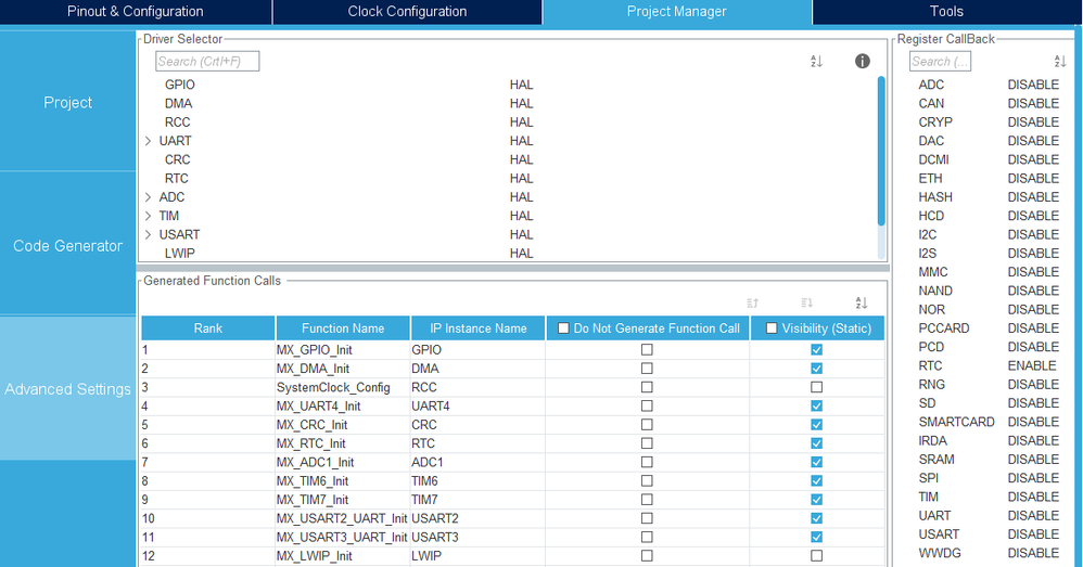

2021-02-23 3:36 AM
You can set the register callback manually in CubeMx via Project Manager -> Advanced Settings -> Register Callbacks (right-hand site). There you can enable/disable register callbacks for each peripheral individually.
