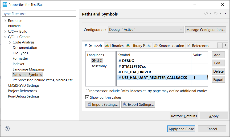

2020-08-07 8:52 PM
You can enable callbacks by defining the macro USE_HAL_UART_REGISTER_CALLBACKS in the Project->Properties dialog:

2020-08-07 11:23 PM
I'm using CubeIDE 1.3.1 and setting the symbol above allows me to use HAL_UART_RegisterCallback() to register callbacks and is working fine. Maybe it depends on the specific target or options selected in CubeMX.

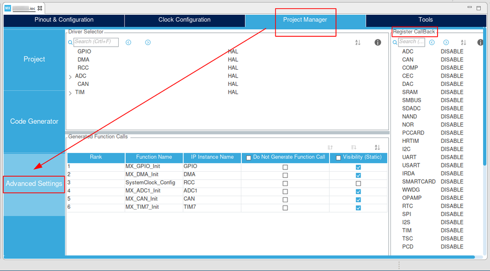

2020-08-10 5:45 AM
It's and old topic, but today i stumbled upon STM32CubeMX Project Manager > Advanced Settings > Register Callback where those settings can be configured.
2020-08-26 8:32 AM
This feature has also been added to STM32CubeIDE 1.4.0 now.
Do note that the Register Callback pane might be obscured, you need to scroll right inside the device configuration window.

2020-10-06 8:54 PM
This trick of the definition in the Project->Properties dialog unfortunately this doesn't work for USE_HAL_COMP_REGISTER_CALLBACKS, even though it looks like it should:

2020-10-06 8:57 PM
Never mind, the below solution in the Project Manager works.
