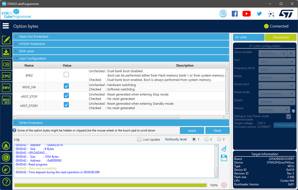

2022-03-26 2:09 PM
The problem was the optional bits. Apparently, when working with the bootloader, I ticked BFB2. Unchecking the box solved the problem. Thanks to everyone who responded!
