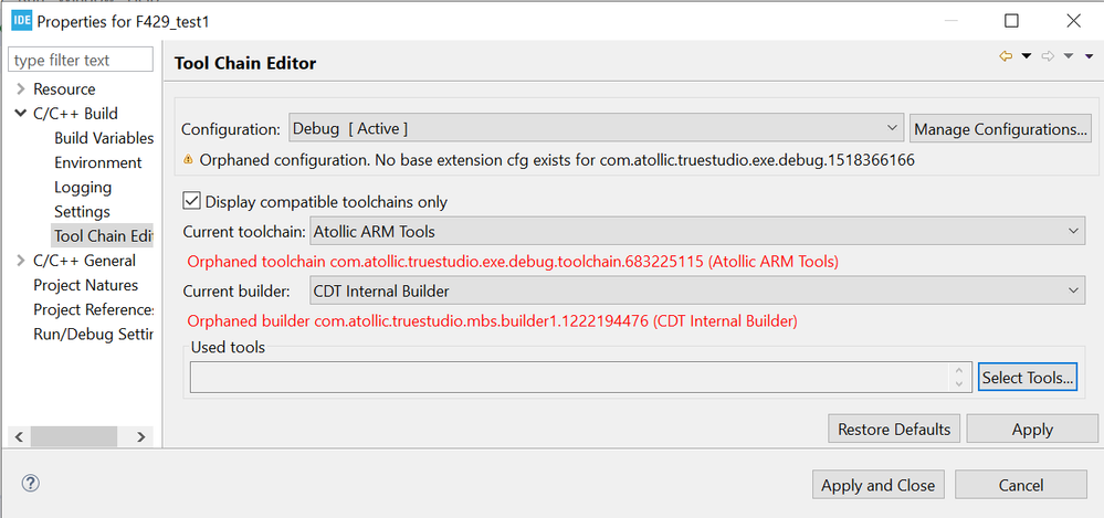

I tried to import an Atollic project into STMcubeIDE (which so far doesn't work at all).
The import appears to succeed, but the ARM toolchain is not set up correctly and shows "orphaned configuration/toolchain":
Has anyone been able to get this to work?
Thanks for any tips!

It looks like you imported the project as an "existing project into workspace" which does not convert the project properly.
You can follow this guide UM2578 which should solve this problem.

2019-05-10 8:45 AM
@Markus GIRDLAND - Thanks, I am able to import, build, and debug this project. Will separately report other bugs...
