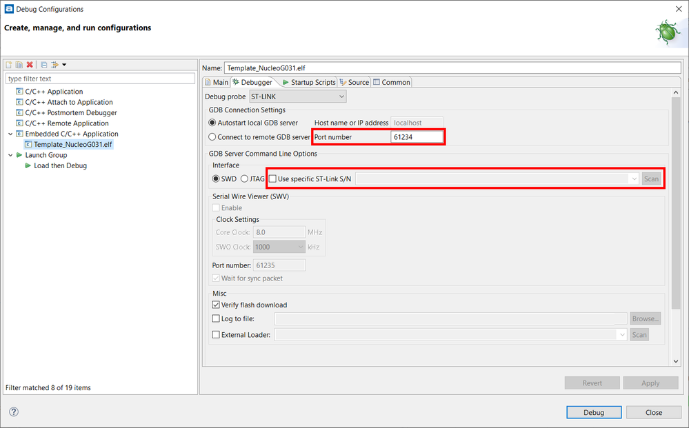

Hello @MDeva.1,
Yes debugging programs with two or multiple boards is possible within STM32CubeIDE.
It can be realized using two ST-LINK or SEGGER J-Link probes at the same time. Please ensure that you are not using the same port number for both projects selected in the Debugger tab in the Debug Configurations dialog.
I recommend you to following the 3.6.3 section "Debug multiple boards" of the UM2609 STM32CubeIDE user guide.

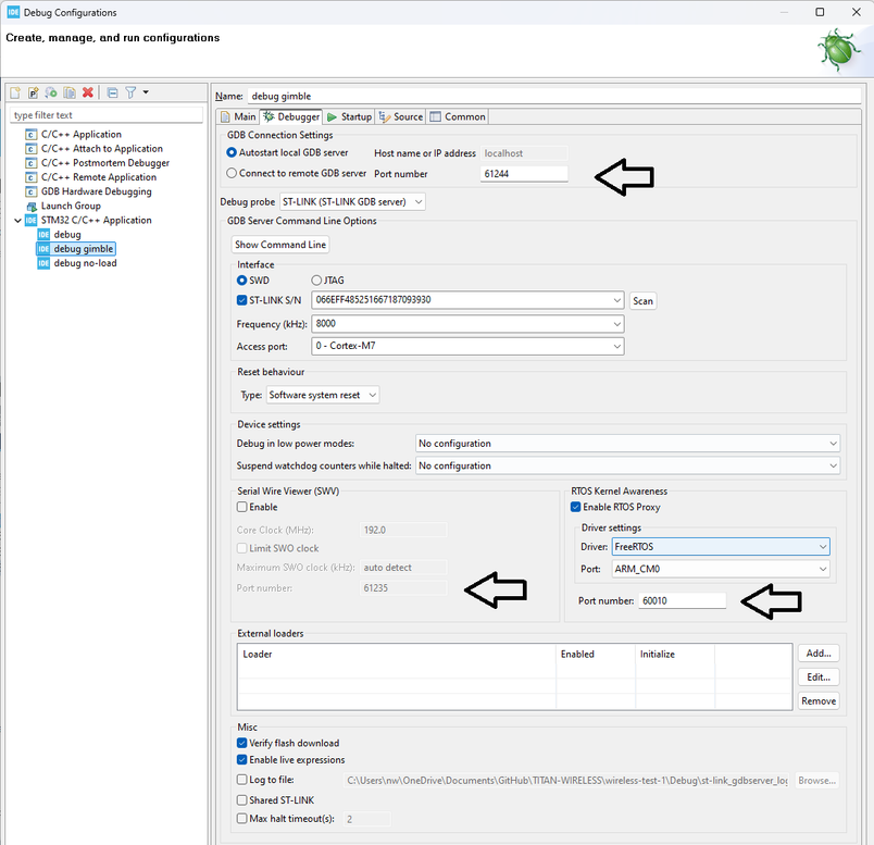

I believe the issue is that both GDB servers are using the same port (usually it is port 61234). You should try to change the "Debug configuration" -> "Debugger" -> "GDB port" for one of the 2 IDE instances (I'm not using CubeIDE, so I can't help precisely here), and maybe also specify the ST-Link serial number to use for each debug instance, so the IDE knows which debugger to use.
See the picture below for Atollic:

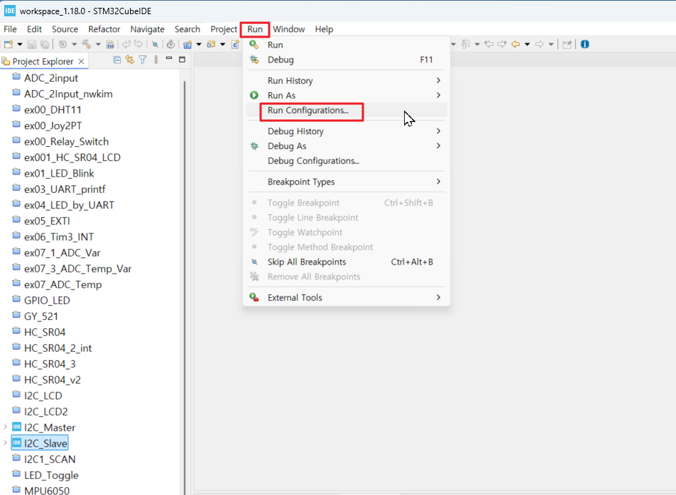

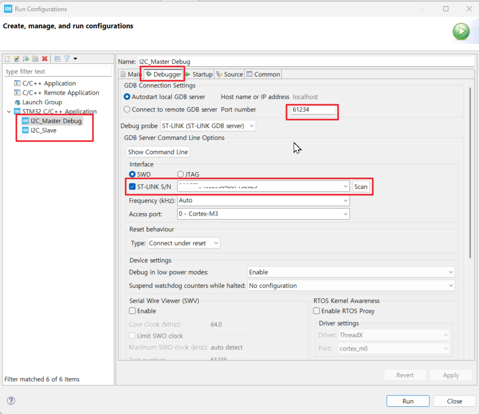

The chapter number 3.6.3 Debug multiple boards mentioned by ChahinezC is now chapter 3.1.6.3 Debug multiple boards of user manual UM2609 as of today, April-22-2025.
Menu of STM32CubeIDE is also slightly changed on STM32CubeIDE 1.18.0.
Select Run > Run Configurations... , and you can find Run Configuraions window.
