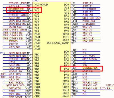

As I can see from your screenshots, you started the project from a board instead of the MCU part number and you selected to initialize all the available peripherals. Here no need to configure USART2 as it was already configured by CubeMx with "initialize all the peripherals" option.
According to the board schematics: USART2_Tx: PA2 and USART2_Rx: PD6:

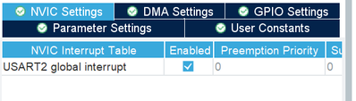

Which is confirmed with CubeMx:
As USART2 is connected to the STLINK-Virtual comport, you can use STLINK as UART- to-USB bridge.
But you need to check all the UART parameters: baudrate, parity etc ..

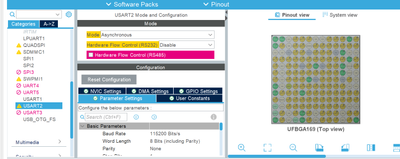

" and nothing on my PuTTy program. I only used this for the code "
while (1)
/* USER CODE END WHILE */
HAL_UART_Transmit(&huart2, tx_buffer, 27, 10);
HAL_Delay(1000);
/* USER CODE BEGIN 3 */
"and i declare tx_buffer as "uint8_t tx_buffer[27]="Welcome to BinaryUpdates!\n\r";". I also attached a photo with the configuration of USART2
