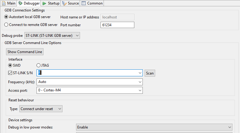

Three of my programmers ST-LINL V2 don't work in STM32CubeIDE! Everything used to be great, I was flashing my boards, doing debugging, but now some nonsense is happening (version of my IDE is 1.8.0). For debugging, I use the interface SWD, and the connection is exactly the same as before. But the most interesting thing is that the program does not see the serial number of the programmer, although everything was fine before. Now I will attach some screenshots.
As you can see, the program considers that my programmer (all three!) have a serial number - F. I absolutely do not understand how this is possible. Programmer firmware update did not work. Fun fact: when the program enters the DFU mode when working with the firmware utility, it sees its correct serial number, but I do not know how to get this number to be displayed in Cube IDE.

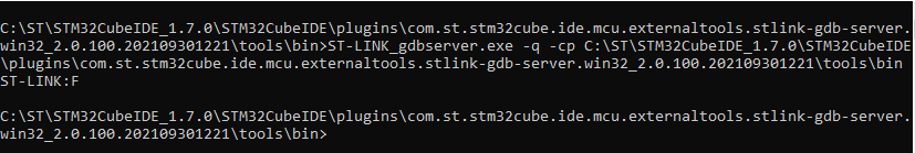

Can you try to only rely on ST-LINK GDB server to return the ST-LINK serial number?
You can do this by:
cd C:\ST\STM32CubeIDE_1.8.0\STM32CubeIDE\plugins\com.st.stm32cube.ide.mcu.externaltools.cubeprogrammer.win32_2.0.100.202110141430\tools\bin
ST-LINK_gdbserver.exe -q -cp C:\ST\STM32CubeIDE_1.8.0\STM32CubeIDE\plugins\com.st.stm32cube.ide.mcu.externaltools.cubeprogrammer.win32_2.0.100.202110141430\tools\binPerforming this first test will allow us to see if there is an error in ST-LINK GDB server or somewhere in Eclipse... This will probably return the correct number.
You can take this number manually and paste it into the debug config if you want to quickly fix your issue.
But from our point of view it would be interesting to narrow this down a bit further...

1. In the drop-down list you are talking about, in addition to the number of the working programmer (I borrowed an isolated programmer from a friend, and it works correctly), there is also a "number" F, but it only appears when I connect a faulty device.
2. I tried to execute the commands you indicated on the command line (however, my paths are slightly different from those you gave), and I got the results that you can see in the screenshot. I can say that it did not bring success.
