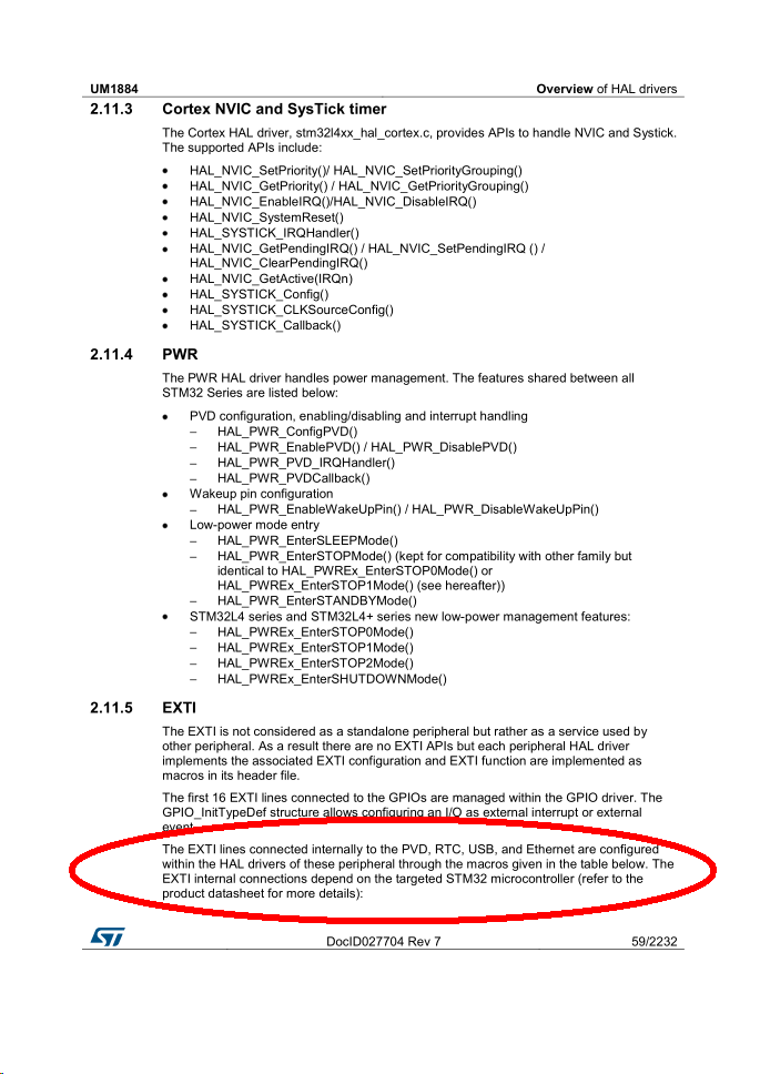

What are ''the 4 EXTI controllers''? Is this some Cube concept? I don't Cube, but maybe this is of some help:
plus the table on the following page; and then the 49 HAL PWR Generic Driver and 50 HAL PWR Extension Driver chapters.
