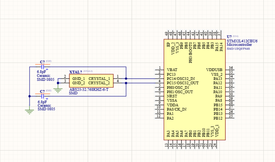

Ouch...
Then the GND connection between STM32 and not only the crystal, but most other components is... terrible.
Always think of GND as a signal.
It doesn't help if you get short "signal" traces between 2 devices, but the GND connection between them is taking "a long way".
Even worse, because GND is kinda "shared connection".
I have performed this testing, and rtc drift in 24 hours is about 20 seconds(earlier 24 seconds) and still device is in testing.

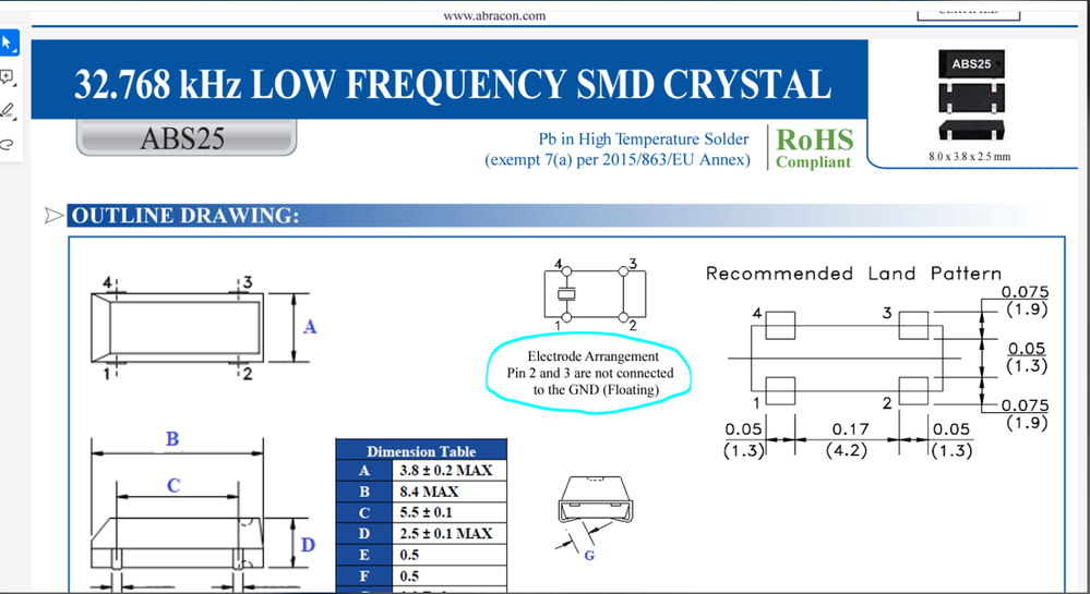

Hello @Peter BENSCH​ , I have some doubt about crystal connections:
As shown in above schematic, crystal pins 1 and 4 is quartz crystal and another two pin (2 and 3) is connected to GND.
In many schematic, we found that some schematic keep crystal other pin floating.
and according to crystal datasheet: https://abracon.com/Resonators/abs25.pdf
Pin 2 and 3 are not Connected to GND (Floating).
So,
1) Is above schematic is ok?
2) What can be impact with GND Connection to pin 2 and 3?
3) What can be impact without GND Connection to pin 2 and 3?

With a load capacitance of 6 pF on a two layer board, a 6,8 pF capacitors are almost surely too small. The appropriate value should be 8-10 pF and I would start with a 10 pF.
