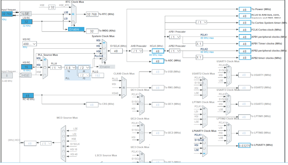

How did you set up your clock tree?

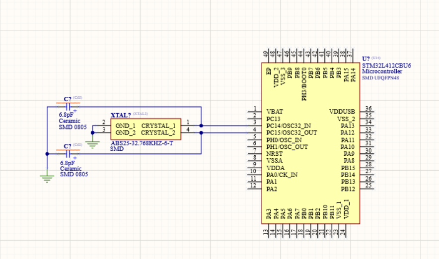

Schematic for crystal:

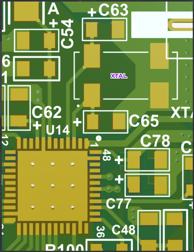

PCB Layout:
no component or tracks below XTAL on bottom of PCB
Peter BENSCH
Well, first of all, the clock scheme looks ok.
You have connected the crystal using very short tracks to the STM32L412C, but GND looks very suspicious: no GND area under the crystal, no guard ring around crystal and its C's, no shortest possible connection from GND (crystal, C's) to the GND of the STM32L412C.
I always have a standard statement for this:
But please don't forget to layout GND accordingly, i.e. shaped like a (GND) hand holding a stone (crystal), where the "hand" must be separated from the rest of the GND layer and only connected via the "arm" to the closest GND pin of the STM32, see AN2867, section 7.2, fig. 14...16. I hope that the linguistic picture illustrates this in an understandable way?
Unfortunately, we don't see where GND is routed from the crystal + C's to the STM32 in your case, nor do we know the circuit, so we can't rule out the possibility that interference pulses are interspersed somewhere that lead to the observed deviation.
Regards
/Peter
waclawek.jan
Super User
As an experiment to confirm Peter's suspicion, try to mount C63/C65 "upright" so that only the crystal-connected terminal is soldered down, and then using shortest possible wires connect their "upper" other ends to the ground terminal of C62.
You may also try to mount the crystal a bit slanted so that its ground terminals are not connected to the pads, and connect those terminals to the same ground as the two crystals [EDIT see Peter's comment below] capacitors [/EDIT]

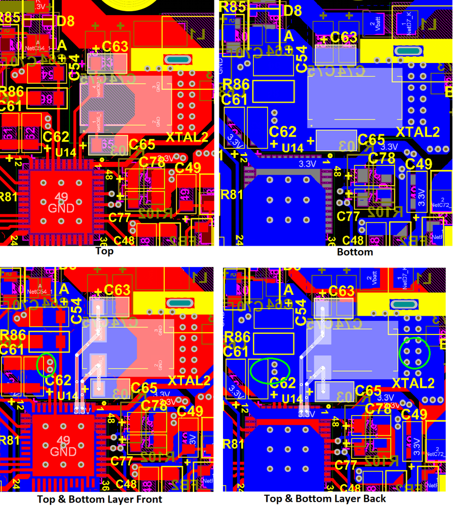

This is bottom and top view of PCB.
Due to size and placement issues, we can't use crystal guard rings, and Crystal GND direct connection to MCU GND is not possible, it is done through via's (Shown in Green Circle).
Please review this.
waclawek.jan
Super User
LSE oscillator is ultra low power, so any small disturbance can influence it. That's why it's important that it does not share ground with any other circuitry on the board: any current flowing together with the LSE current can influence LSE.
You also can try to play with RCC_BDCR.LSEDRV, but I would recommend you to make the experiment I outlined above first.
