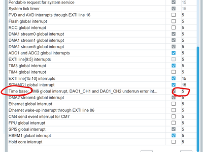

2025-02-16 7:40 AM
The tick priority needs to be higher (numerically lower) than the interrupt you're calling HAL_Delay from.
So for you, that means TIM6 and TIM7 interrupts need to be under 5 if you're calling HAL_Delay from another interrupt with priority 5.

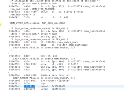

Further update, a look at the CM7.list file reveals where the problem arises:
Clearly the HSEM is using address 0x30004000, which is where CM4 has been told it can start using SRAM1, and CM7 as been told that it can't access any more than 16 kB running between 0x30000000 & 0x30003fff (see the two linker scripts shown in my last update).
Isn't this a bug?
