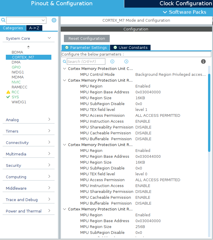

After a lot of odd hard fault I focused again on MPU configuration and I discovered LL CUBEIDE MPU TEX setting got ignored. Is this a bug or am I wrong in some way?
generated code snippet here

}Must be IMHO

}Thank anyone try address this issue.
