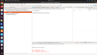

I don't want to use MPU; I just want to know if it's possible to load a bin file onto the dual-core controller using stm32loader (a Python-based loader for loading bin files into the controller) or stm32cubeprogrammmer.
One more thing , when I try to run a simple example in STM32CubeIDE, such as controlling three LEDs where the first LED is controlled by the M4 core and the second LED by the M7 core, I encounter a hard fault error. I'm unsure why this error is occurring. I have shows the error in below.....
