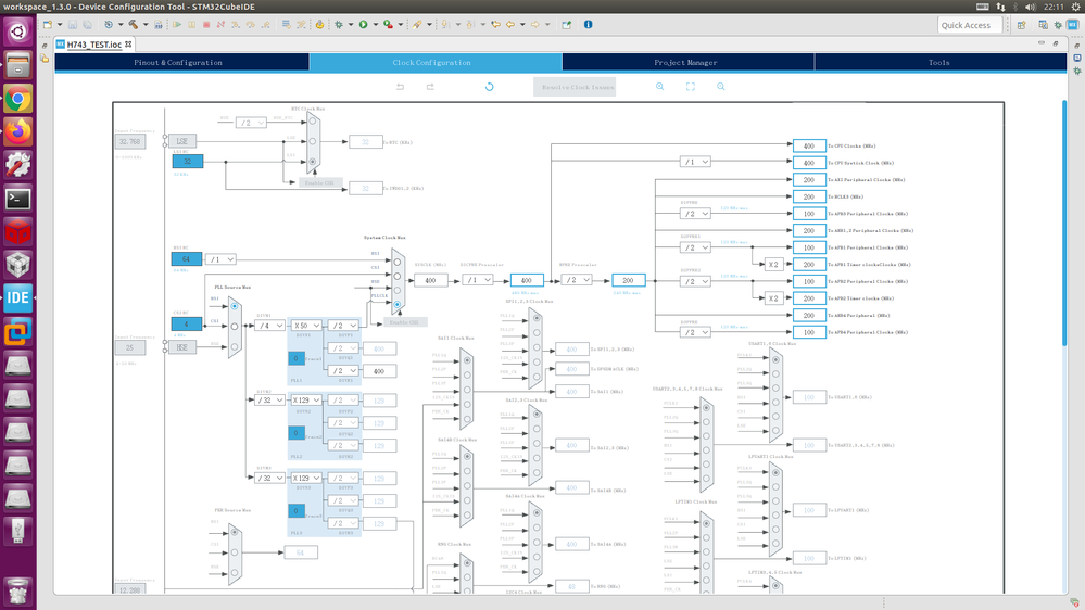

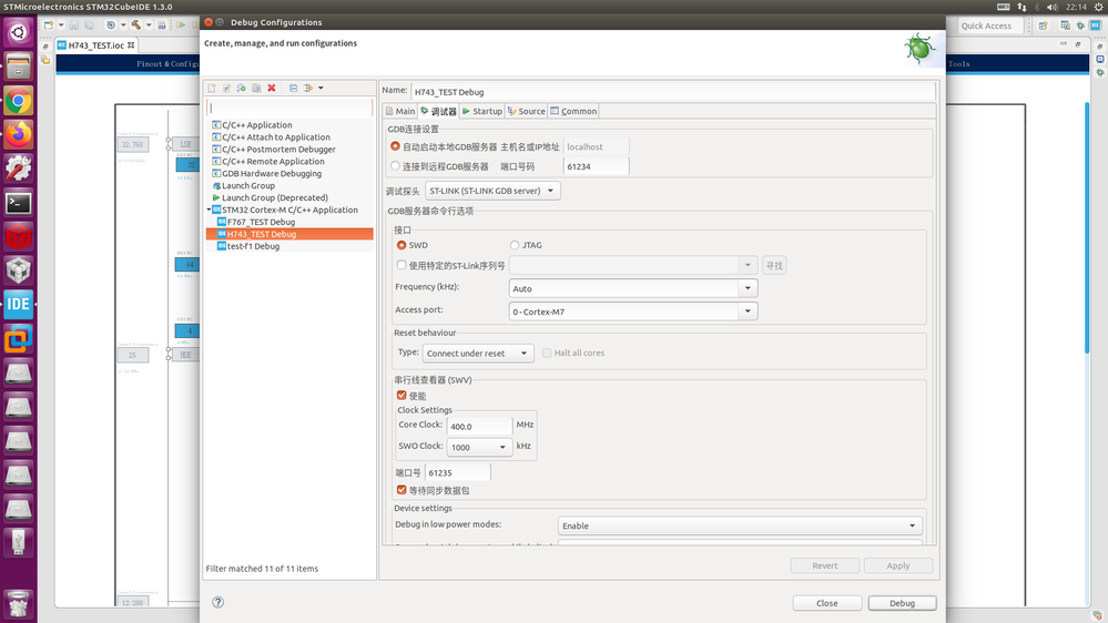

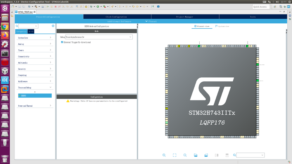

I debug stm32f767 on stm32cubeide using stlink v2 or stlink v3 through the jtag interface can normally use swv data tracking timeline graph ,but the function (swv data tracking timeline graph) in stm32h743 does not work, the error message is
(Target is not responding, retrying...
Debugger connection lost.
Shutting down...
Please tell me what should I do and why this problem occurs, thank you very much.
