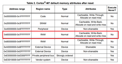

You need to enable the cache and place your data in a cacheable region (need to configure the MPU if it was not a cacheable region by default like SDRAM at 0xAXXX XXXX). It follows this default ARM MPU attributes:
As you are using the SDRAM at the address 0x6XXX XXX. If you enabled the cache it's definitely cacheable.
DTCM (as Data Tightly Coupled Memory) is not the D-cache it's a RAM that doesn't profit from the cache. Enabling or disabling the cache doesn't change the access performance to the memory.

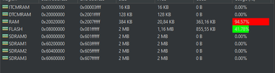

sorry for bad expression, i meant DTCMRAM. I dont understand these caches - i didnt use it never before. I thought that enabling of cache speeds up access for the screen buffer in external SDRAM via FMC. So i enabled it. In some moment i find out, that i dont have 512kB RAM but only 384kB. The DTCMRAM consumes 128kB and ITCMRAM 16kB. When i instantiated static array of floats, the program starts causing bad behaviour because i overlap by this static array from 384kB SRAM into DTCMRAM section. When i disabled cache i've got again 512kB SRAM and program worked as expected. But im not sure if TouchGFX has the same speed access into external SDRAM with disabled caching in comparison cache was enabled(im using 800x480 16bpp TFT over LTDC). I have added MPU regions for whole 8MB of external SDRAM and 4x2MB for each bank.
Im able to place global variables into DTCMRAM when i added DTCMRAM into linker script but im not able to place here variables defined as static. I want to declare these variables in internal RAM because program periodically computes FFT and DSP filternig stuff and im not sure if FMC is able to handle this together with display buffering without artefacts on TFT screen.
So what do you recomend for this applicacion? Stay with disabled cache and have 512kB space of SRAM or enable cache and use 384kB space of SRAM and 128kB space of DTCMRAM?

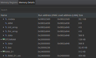

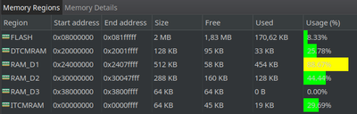

You can check in mem.details , where its going to be :
Then you see: is your linker script as you want it - or not.
