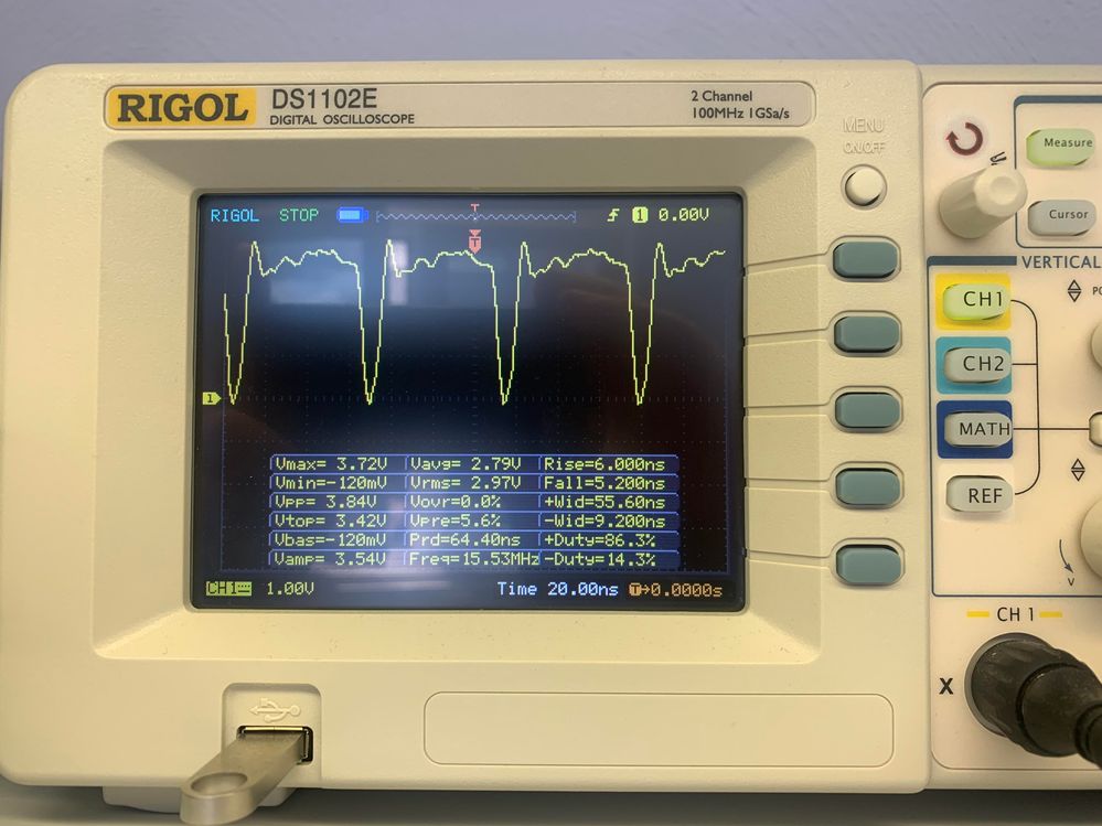

If I put a breakpoint in the loop so that the program pauses before every qspi_read_id() call. Before read_id is called the very first time, the only flag in QuadSPI->SR status register is Fifo Threshold Flag. If I continue the program, 1 second later I'm paused right before calling read_id again, and I already have flags "busy", "transfer complete" and the same "fifo threshold".
The D0 line is definitely firmly stuck at 0v, the scope never triggers. Chip select goes crazy after the first time read_id is called and never stops even while MCU is paused on a breakpoint:
I have obviously misconfigured something, but I'm out of ideas. I read some materials on the topic, will keep researching too, but I was hoping maybe someone could point me in the right direction.
