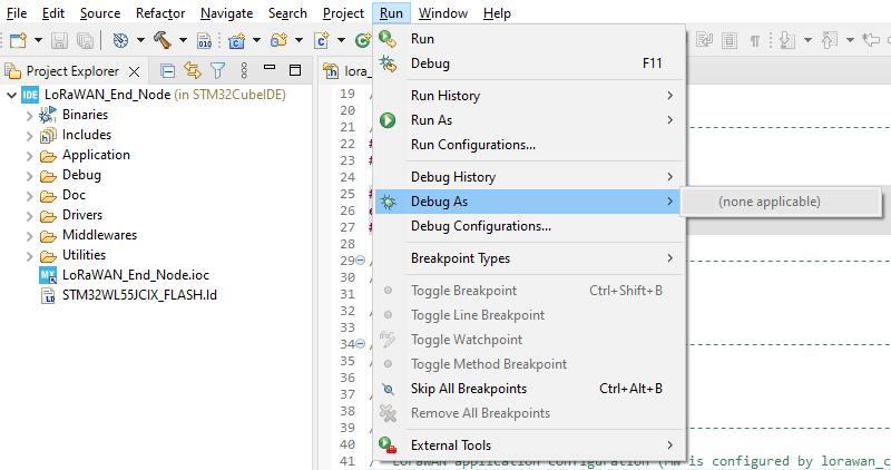

Hi I am facing the same problem, following the lorawan stm32 tutorial on youtube (cant post link), but the STM32 Cortex-M C/C++ Application is missing.
Please advise

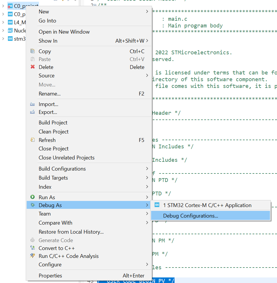

I don't think you have an option there because you don't have a debug configuration. If you right click the project in the project explorer you should get the menu to open the debug configurations:

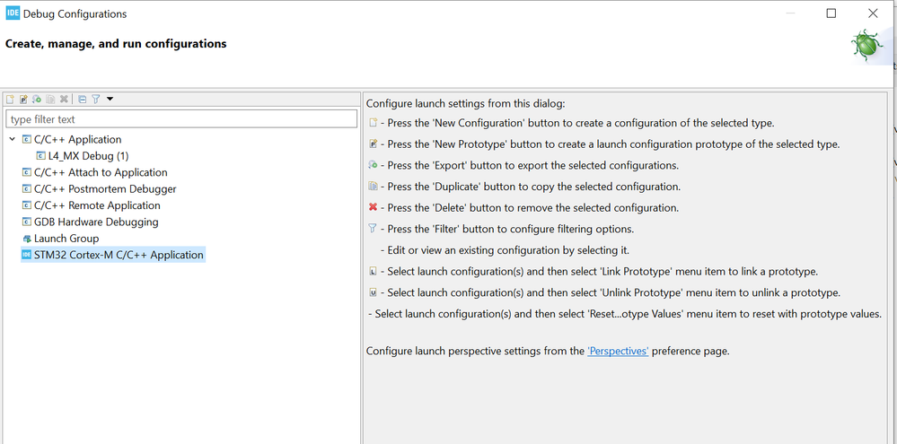

From there you can double click on the "STM32 Cortex-M C/C++ Application" to create your debug configuration:
