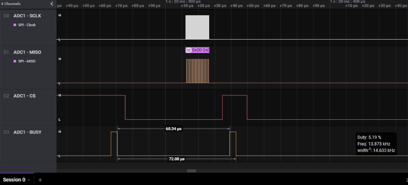

I've built a custom system using the STM32F733xx and an external ADC (TI ADS8588S) connected over SPI. I have verified that the system works consistently using the STM32 HAL L0_V1.2.8 when transferring data via the blocking/polling method. However, when I configure the SPI to run non-blocking with a linked DMA I can only get one full transfer to complete. Successive transfers fail to produce SCLK as shown below:

}The issue is that HAL_SPI_TransmitReceive_DMA call errors out on the 2nd call with HAL_BUSY because hspi->State is HAL_SPI_STATE_BUSY_TX_RX. I thought the root cause was related to SPI Tx sending dummy data and asserting the DMA_FLAG_FEIF3_7 flag but clearing this didn't help.
I cannot see how to reset the SPI1 DMA so that successive transfers can happen. I have suspicions on the status flags (TXE, RXNE) but I cannot see what is wrong.
