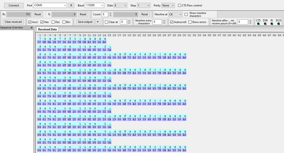

Here's my code:
int main(void)
	float tmp_flt = 1.543;
	uint32_t apb1Clk;
	char tmp_ch = 'A';
	char tmp_ch1 = 'B';
  HAL_Init();
  SystemClock_Config();
  SystemCoreClockUpdate();
  apb1Clk = HAL_RCC_GetPCLK1Freq();
  MX_GPIO_Init();
  MX_RTC_Init();
  MX_SPI1_Init();
  MX_UART5_Init();
  /* USER CODE BEGIN 2 */
  HAL_Delay(500);
  while (1)
	  HAL_Delay(500);
	  printf("printf float: \n\r");
	  printf("data on line 2\n\r");
	  printf("data on line 3\n\r");
	  HAL_Delay(500);
printf is used by using following function:
#ifdef __GNUC__
#define PUTCHAR_PROTOTYPE int __io_putchar(int ch)
#else
  #define PUTCHAR_PROTOTYPE int fputc(int ch, FILE *f)
#endif /* __GNUC__ */
PUTCHAR_PROTOTYPE
  HAL_UART_Transmit(&huart5, (uint8_t *)&ch, 1, 0xFFFFFFFF);
  return ch;
Terminal view is as follows:
Kindly go through it, anything else you need just tell me.
Waiting for your valuable input.
waclawek.jan
Super User
Very interesting - almost completely repeatable, and much of the characters gets through unaffected, that's remarkable.
I'd say, there's some slight baudrate mismatch involved. I know you are using HSE/crystal and the baudrate is not that high compared to system clock, so the mismatch should be relatively low; but what's on the receiving side? Is it some USB-to-UART converter? Can't that be mismatched? Can you try a different one (different make, different chip)? Or, even better, can you locate a PC with an onboard UART? Can you try to transmit on it and measure precisely enough the bit duration (you need to get to some 1% resolution at least)? Is there some level conversion involved (RS232)?

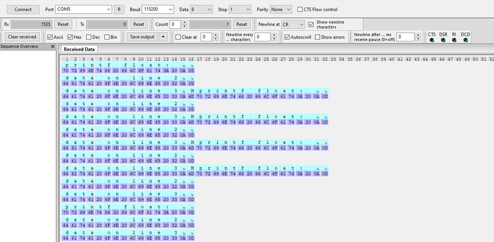

Rahul1
Associate II
You are right USB to RS232 converter was the issue.
Changed it with FTDI FT232RL.

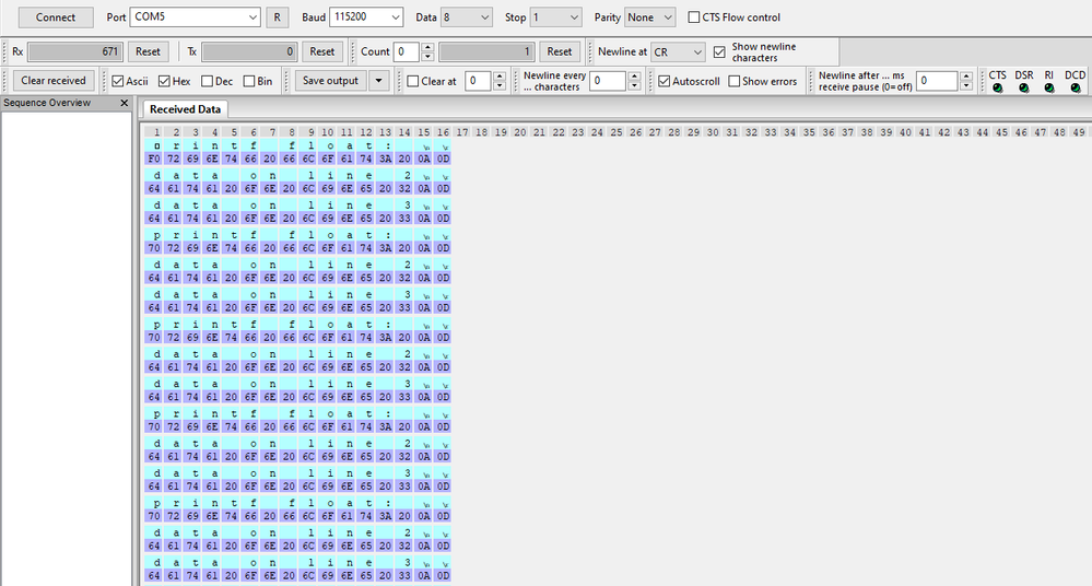

Now issue is little different as you can see below
and also like below:
Please check
waclawek.jan
Super User
I honestly don't know. At this stage, you might really need an oscilloscope or maybe even better a logic analyzer and look at the actual Tx signal.
