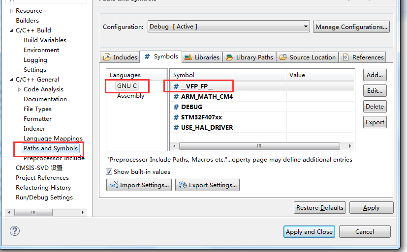

If I define a floating point data,when i use this data,it will be case HardFault.

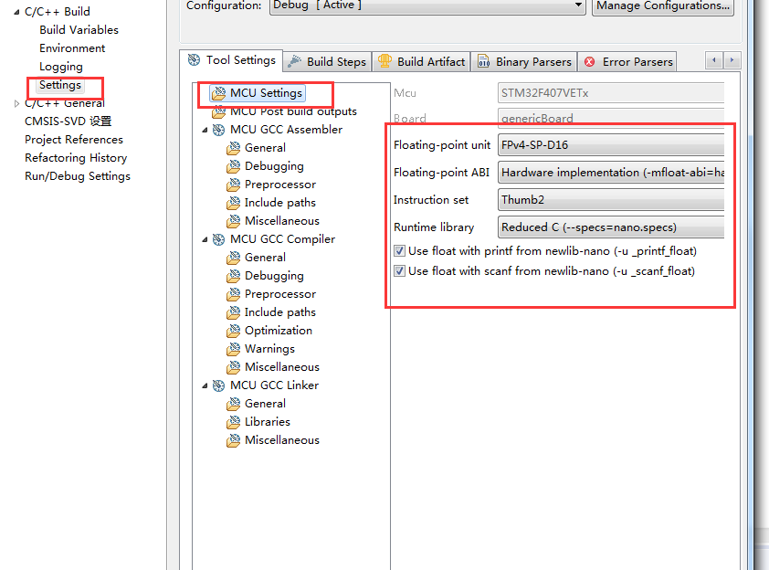

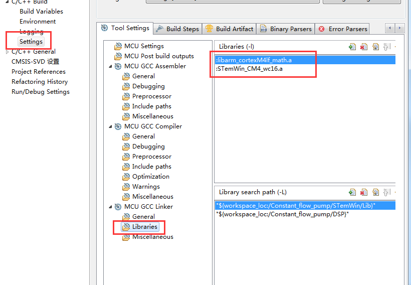

add the lib
open the FPU
define __VFP_FP__

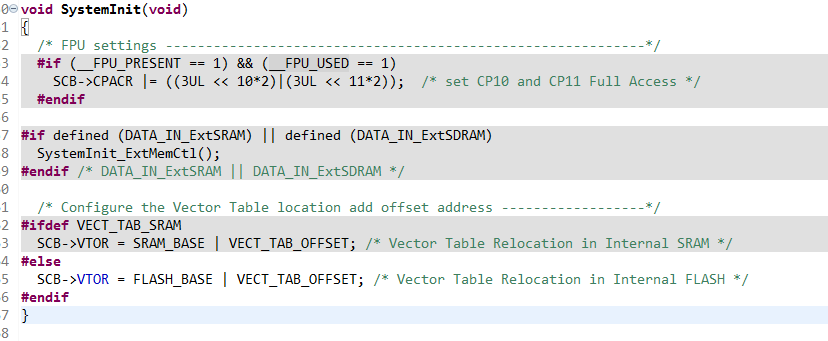

but in SystemInit FPU Settings cannot be performed

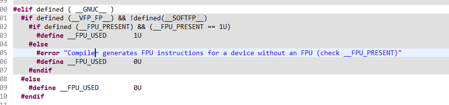

because in core_cm4.h, __SOFTFP__ is defined ,but i can't find where __SOFTFP__defined

i set the Floating-point ABI Hardware ,why .fpu=softvfp?
Are you sure? Set a breakpoint and try it out. The code lines are grayed out, but this is because the IDE cannot deduce the correct settings because __VFP_FP__ and __SOFTFP__ are predefined by gcc (depending on settings).
For me, if I write some test code in main:
#if __FPU_USED==1
volatile float a = 1.0;
volatile float b = a*a;
volatile float c = asin(b);
#endifthe test code is executed (despite being grayed out by the IDE) and works.
Build log (compile step):
arm-none-eabi-gcc "../Drivers/STM32F4xx_HAL_Driver/Src/stm32f4xx_hal_uart.c" -mcpu=cortex-m4 -std=gnu11 -g3 -DUSE_HAL_DRIVER -DSTM32F446xx -DDEBUG -c -I../Drivers/CMSIS/Include -I../Drivers/STM32F4xx_HAL_Driver/Inc -I../Core/Inc -I../Drivers/CMSIS/Device/ST/STM32F4xx/Include -I../Drivers/STM32F4xx_HAL_Driver/Inc/Legacy -O0 -ffunction-sections -fdata-sections -Wall -fstack-usage -MMD -MP -MF"Drivers/STM32F4xx_HAL_Driver/Src/stm32f4xx_hal_uart.d" -MT"Drivers/STM32F4xx_HAL_Driver/Src/stm32f4xx_hal_uart.o" --specs=nano.specs -mfpu=fpv4-sp-d16 -mfloat-abi=hard -mthumb -o "Drivers/STM32F4xx_HAL_Driver/Src/stm32f4xx_hal_uart.o"
Build log (link step):
arm-none-eabi-gcc -o "STM32F446RE_float.elf" @"objects.list" -mcpu=cortex-m4 -T"...\STM32F042K6\projects\STM32F446RE_float\STM32F446RETX_FLASH.ld" --specs=nosys.specs -Wl,-Map="STM32F446RE_float.map" -Wl,--gc-sections -static --specs=nano.specs -mfpu=fpv4-sp-d16 -mfloat-abi=hard -mthumb -u _printf_float -u _scanf_float -Wl,--start-group -lc -lm -Wl,--end-group
Everything seems okay.
