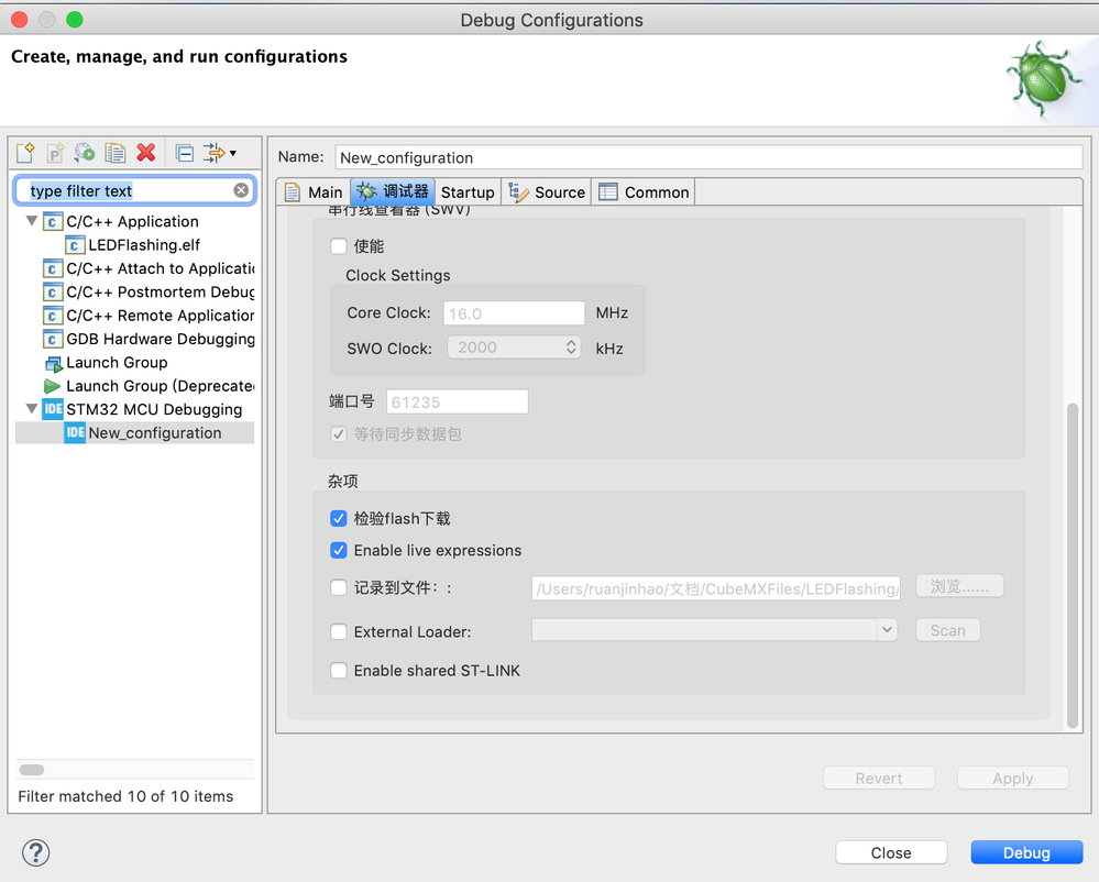

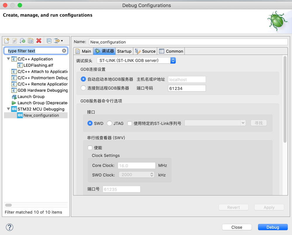

I think it's not hardware's problem because I can download my program in Keil uvision successfully. and my debug configuration is showed as follows:
2019-05-13 7:52 AM
Under the "Enable live expressions" there's a box where you can enable a log. Can you activate that one, make a new try to debug and then send me the log?

2019-05-14 5:35 AM
How is your workspace and installation set up?
I noticed the log gets logged to "文档/CubeMXFiles/TEST/Debug/st-link_gdbserver_log.txt" and any non-ascii characters in workspace path, installation path, project name or workspace name can give bad results.

2019-05-15 6:37 AM
So neither workspace path nor installation path have any non-ascii characters now?
Is it some kind of custom board? I would make sure contact with the board is good and also make sure you point out the correct ST-Link in the debug configuration if you have multiple connected or perhaps a previous one saved.
Do you have TrueSTUDIO or stand alone CubeProgrammer installed? If so, what are the results with those tools?
This error is usually due to a simple connectivity issue.
