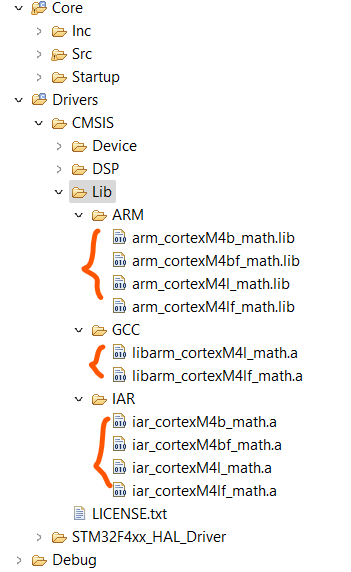

I've followed this tutorial to install the DSP libraries on STM32F407 discovery.
Should I keep all the files in the folders in the attached picture? Or only one per folder? (i.e. according to the uController I choose which one to keep)
I think I have to delete the IAR and GCC folders, leaving only ARM, am I wrong? And inside this ARM folder should I delete something? What's the difference between b, bf, l and lf?

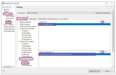

STM32CubeIDE use GCC compiler, so you need to keep the GCC folder.
Note that it is necessary, when you use the DSP Lib with STM32CubeIDE, to add the "arm_cortexM4lf_math" library and the path location file which is in a GCC folder (note 6 and 7 in the figure).
So, you don't need to delete any folder.
