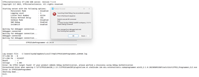

I used cubeMX to set up I2C it selected pins 58 and 59, all is well with uploading without the pullup resistor on pin 59 (10k) testing I2C transmit working fine.
Here is the output with resistor attached , And the cubeMX diagram below that.
Pulling the resistor when Retrying is being sent stopps the retry but hangs,
removing resistor and uploading again (using debug button on stm32cubeIDE works and completes)

I have moved SDA from pin 9 to Pin62 Regenerated code But i still cant program the chip when I have a pullup resistor tied to that pin. Here is another error display.

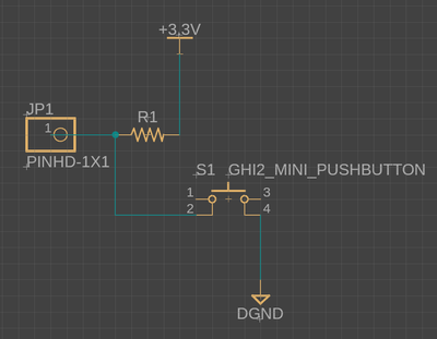

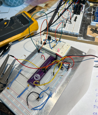

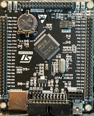

I have added a button to my setup to pull the pin low that allows me to continue developing and that works, but there should not be this problem. my setup below, this board i purchased from newbiehack.com, he solders the chips onto his own breakout boards. I am use to using Atmel DIPs so in cases like this i would just swap to another chip but i only have the one stm32 at the moment, I do also have a STM32F407VET6 dev board from china X003FQDN79 , I understand perhaps these are clones but i'm just getting started programming these so expect trouble along the way.
I did test down to pins 62 down to 35 those two I2C pins are the only ones, makes me appreciate my Power Debugger on the Atmel chips much faster programming. How fast it the new ST programmer V3 compared to a st-link v2 by the way.
I also have a 3.3 power supply connected , i see the st link v2 can power and program without external power but typically I have power to the chip supplied with all my other Atmel programmers, ICE, Dragon, Power Debugger, JTAG, all of them.

This one look real?
2023-09-18 5:48 AM
That's not a genuine board either.
https://stm32-base.org/boards/STM32F407VET6-STM32-F4VE-V2.0.html
Perhaps look at st.com to find a board, or choose one in STM32CubeMX. The nucleo boards are relatively cheap.
