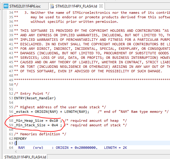

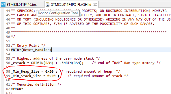

I' thinking I've faced same issue as Ralf but maybe found a trick about.
Based on STM32L011F4P6 device I'm getting:

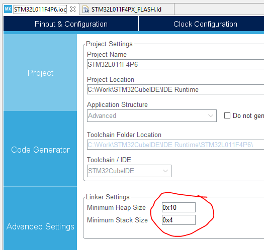

1) Let's define small stack & heap sizes within device configuration editor
2) Generate related code (Alt+K or Project > Generate Code) => I'm getting expected result i.e. linker script in sync. with my setup

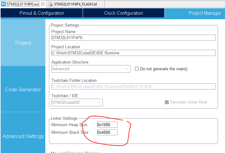

3) Have a new try. Let's define large stack & heap sizes within device configuration editor
4) Generate related code (Alt+K or Project > Generate Code) => I'm NOT getting expected result i.e. linker script not in sync. with my setup ???

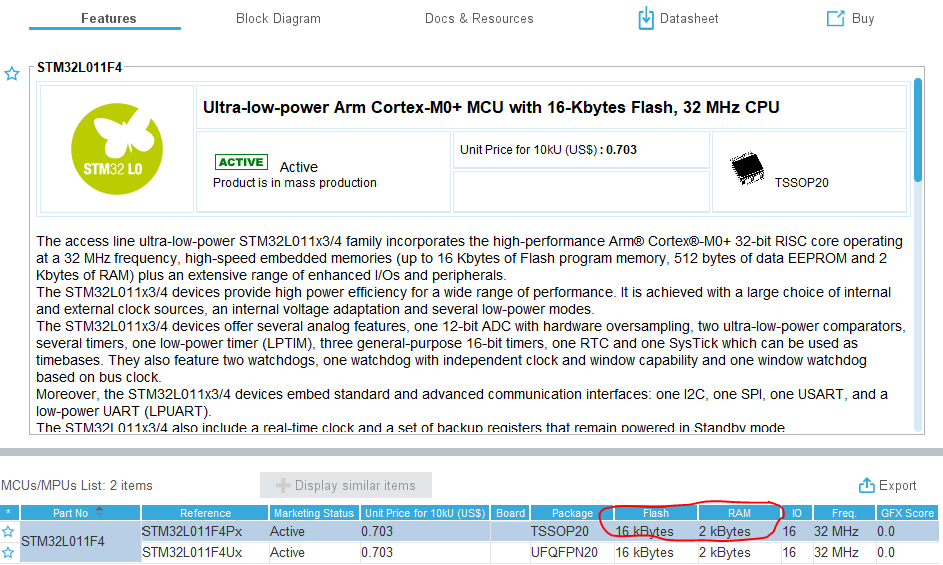

5) Doing some extra trial I confirm not able to face same issue if some more high end devices (F7, …) => is CubeIDE doing some automated stack & heap size clamp depending on target capbilities ? Looking back at STM32L011F4P6 device such one is very low end one (very few Embedded memories) …. maybe that's why ?

thank you for verification. Based on your description, I did some further tests. Changing the heap/stack size in lower area works, the change is always reflected when rebuilding. Bigger values are not recognized. In my old setup (Atollic + CubeMX 5.x), the changes where always reflected, that's why I assume it's a bug. Now, how to point the IDE developers to this?

By the way yes sounds disturbing behavior but does not such makes sense ? i.e. not allowing a stack & heap sizes which may overflow hardware capabilities ? First guess would be happy about except UI issue here as if clamp process may be ok such is not reflected within UI ….

I agree that it would make sense that the IDE takes care of values which overflow the capacity of the device. In my case, I use 512 Bytes for stack/heap in total, so it's within the limits of the device, but those values are not accepted. And if the IDE monitors the values and skip them because of overflow, an error message should be shown.
