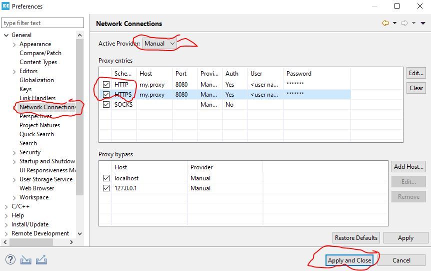

Have you got a try setting network preferences ? Most of time issue is here playing behind a proxy ...
Common Eclipse trick to check if your setup is fine is to get a try to access to Eclipe Marketplace Help > Eclipse Marketplace. If failing means your setup is not ok to access outside world ...
