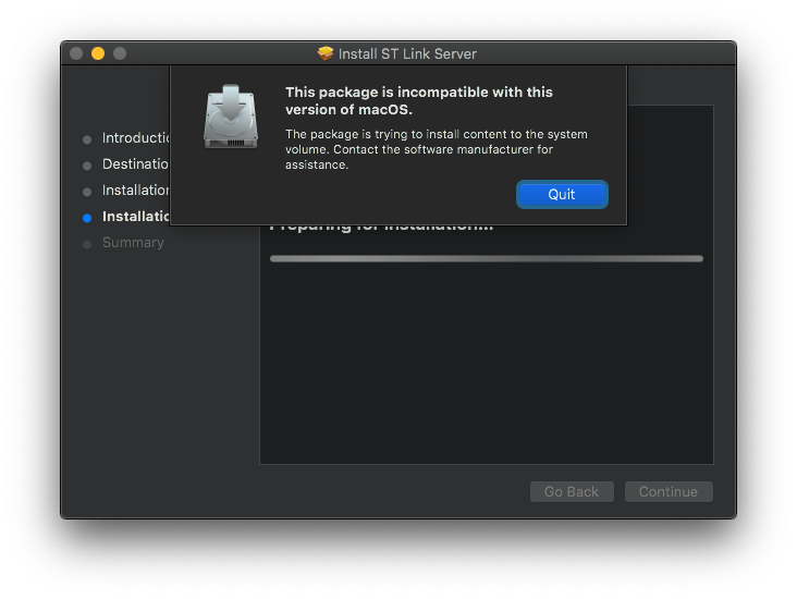

Hi everyone!
I try to install STM32CubeIDE in my MacBook Air it turns out there is a problem that is caused by macOS Catalina. When I try, it fails with the following error message: "This package is incompatible with this version of macOS. The package is trying to install content to the system volume. Contact the software manufacturer for assistance." (see screen capture)
Is there a way to solve this problem? Is there a revised version coming soon from ST?

it can safely be ignored and it is suggested you install openocd. i used homebrew.
from the v1.1 release notes of STM32cubeIDE:
The link to the release notes is:
Search the web how to setup stm32cudeide to use openocd for loading and debugging.

2019-11-05 12:16 AM
ignore the error in case you ran it.
dont install the ST-Link Server .pkg file at all.
In a terminal run
brew install openocd

Ignore Homebrew and all of that stuff; at the time I reported the problem the version of STM32CubeIDE wasn’t working correctly on MacOS. I don’t know if now they have fixed the problem, but I was able to solve the issue by simply installing the 1.0.2 version of STM32CubeIDE.

Hey, I have also a mac with catalina and had the same problem.
But I think I have a working solution for us.
If you installed stm32cubeide 1.20 and you cannot starting it cause of an error want the system deleting the prog.
Install an other JRE 8 and start the IDE from the terminal. Go for it into this folder structure: /Application/STM32CudeIDE.app/Contents/MacOS and here execute stm32cubeide and it will starting.

Hi, I know it is a bit late, but I just installed Catalina. The xattr solution at this link worked for me:
More specifically I did:
sudo xattr -rd com.apple.quarantine /Applications/STM32CubeIDE.app
to allow gatekeeper ignoring key-sign of this app
