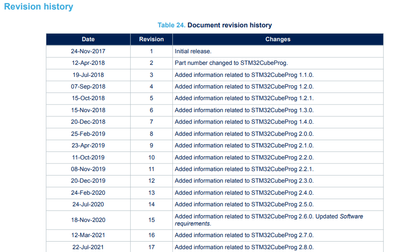

by default all STM32CubeProgrammer versions prior to that date are supported and I can confirm that version 2.5.0 is supporting Windows 7.
More details on versions are here :
Hope it helps you, Then you can try newer versions if it work on your selected STM32 series and see.

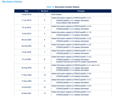

@STOne-32Thank you; is there such a chart for STM32CubeIDE? I was trying to avoid downloading, installing and trying each version of both tools.

@STOne-32 Thank you, but do you internally have access to old Release Notes so I can see exactly where the Windows 7 support ended? I'm just trying to save much time installing/trying/uninstalling each tool, for many versions.
