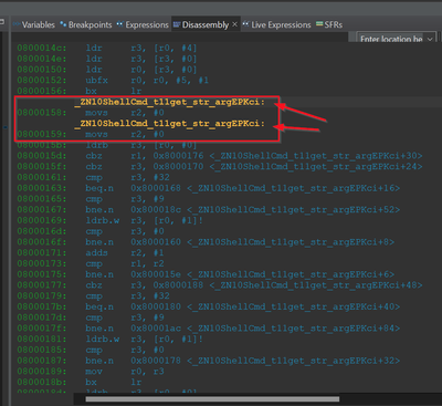

2024-07-23 4:14 PM
I observe a very similar issue. Disassembly window shows incorrect addresses: uneven base addresses for instructions not matching disassembly in .list file.
STM32CubeIDE Version: 1.16.0 Build: 21983_20240628_1741 (UTC)
STM32F103
I used -O2, tried both -g and -g3.
Disassembly in .list file (correct):
const char *ShellCmd_t::get_str_arg(const char *s, int arg_idx)
for (int i = 0; i < arg_idx; i++)
8000158: 2200 movs r2, #0
while (*s != 0 && (*s == ' ' || *s == '\t'))
800015a: 7803 ldrb r3, [r0, #0]
Disassembly in STM32CubeIDE window: (incorrect):
08000156: bx lr
_ZN10ShellCmd_t11get_str_argEPKci:
08000158: movs r2, #0
08000159: movs r2, #0 <---- duplicated instruction with address shifted by one
0800015b: ldrb r3, [r0, #0]
Debugger then steps incorrectly over these instructions that show incorrect addresses.
It happens randomly at different functions, even library functions like __do_global_dtors_aux or frame_dummy.
